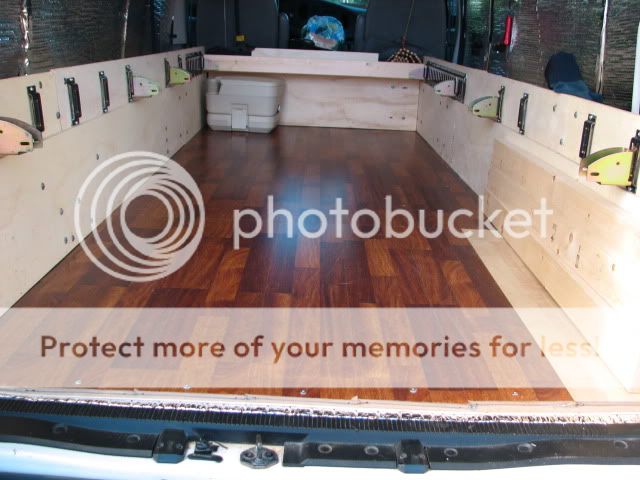

just checked 2010 sprinter specs. it showed 5395 as the curb wt. payload 3155. there is definitely a diet plan in your future.:D i take it you have turned that cavernous space into a 2 x 48" skid sprinter
take the particle board off the walls exposing the reflectix. that is heavier than your insulation alone. trade the 2 gens for a 3000. the van is new how many tools do you need? how many computers can you use at one time?
you might be surprised that the aluminum cargo walls are a big source of weight. a couple sheets of 1/2 plywood works very well.
this works:
