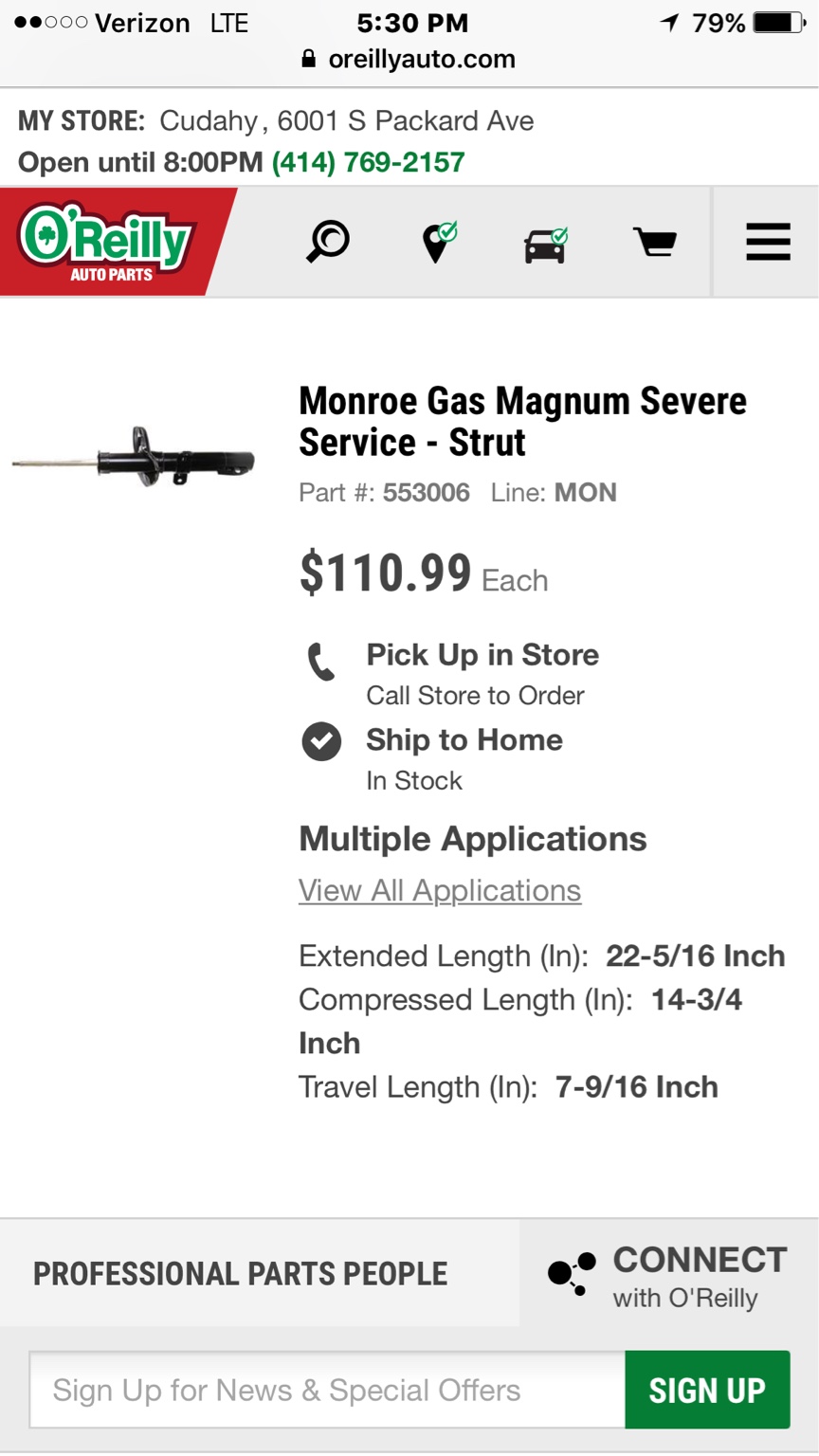

      WOM, my dealer gave me a service department DVD disk. When I get home I'll look up the front strut replacement. Can't believe the dash would need to come out! Remember before the Transit's were released people were saying the headlight bulbs weren't replaceable, they were saying that you had to buy the complete headlight assembly. Turns out it's just 2 easy screws right on top of the headlight assembly for bulb replacement. The struts themselves are reasonably priced.

      Well I just visited my favorite dealer and had a nice chat with the service manager. Dash does not need to be removed. Certain lower dash parts need to be removed. Stuff like the lower panels on the floor, drink holder, fuse box cover on the drivers side. On the passenger side, the strut is accessible by removing the glove box door and inner glove box. And Ford flat rate is 5.8 hours. Warranty flat rate is 3.6 hours. And the original Ford strut is actually cheaper retail price then the aftermarket strut. $109 retail and just over $90 with my discount. They agreed to a lower $90 shop rate for the 5.8 hours for you and will install aftermarket struts for no extra charge if that's what you prefer. They will do mine, when needed for $90 for the 3.8 hour flat rate. When mine wear out, I'll probably just try and do them myself in my driveway. Rear shocks are easy.
      Plus they printed out that section of the service manual for me. I could email scan copies if you needed them.
