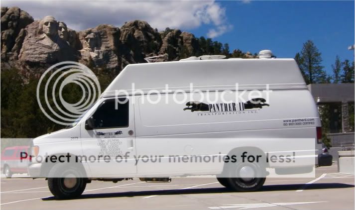

I might be a little more connected than most but I had a 10 gallon propane tank mounted under my van. it came from a RV. It ran a RV heater and RV stove.
Yes, I got the "rv" stuff from a buddy that used the rv in a demo durby. He gave me everything. Still have most of it including the 2CF 12V/120V fridge.
i wish I could find more photos of my old truck. It had the Heater, the fridge and the stove all mounted behind the drivers seat. The cargo wall moved. When I was empty or had one pallet I could slide the wall back and have room to stand between the bunk and the front seats. TV and microwave sat on top of the roof over the front seats. When the bed was all the way forward it would hold two pallets (102" deep) and the only thing I could not use was the stove.
You can see the propane tank just behind the drivers door on the underside of the van.
