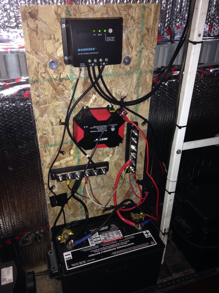

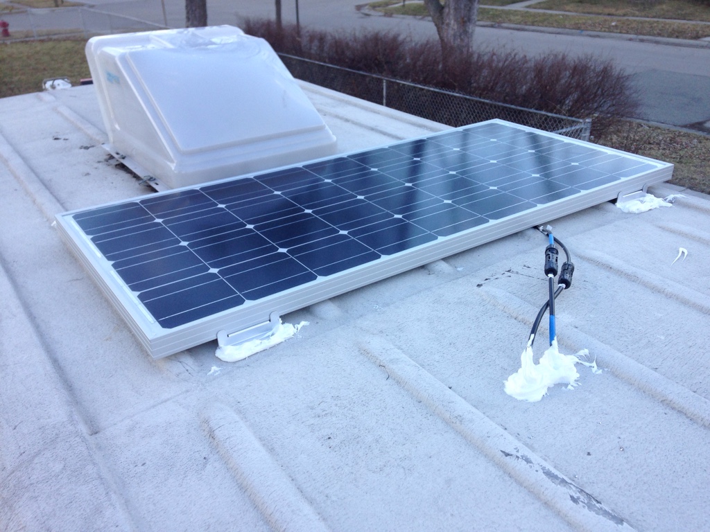

I'm no tree hugger, but I do like having enough power to run all my comfort gadgets in my Sprinter without having to use the generator and running down my auxiliary batteries. I was already into using anything solar. Previously utilizing solar rechargeable lights, glow in the dark pads, large jump box for charging things. But eventual, power is depleted.
So with my progression, I decided it was time to make a bigger jump to a solar panel to help keep my two auxiliary batteries charged.
The box unveiling...
And the final install...
Already planning on adding a 2nd panel if needed
Special thanks to Turtle for all his help and guidance, as I am very electrically challenged

I went with this starter kit. I did the install myself.
Amazon.com : Renogy 100 Watts 12 Volts Monocrystalline Solar Starter Kit : Patio, Lawn & Garden
Depending on how involved you want to get with the hook up, some extra cost for accessories. I needed to get my battery bank in better order anyways, so I did more then was necessary with the basic kit.
Just got off the phone with tech support. I was a little concerned that since last night my bank is already fully charged on a cloudy rainy day at 14.5 volts. They said this was normal and will settle back down to 13.8 volts.
Picture of the included solar control...

No, your not seeing double. As I pretty much planned from the beginning, installed my 2nd solar panel today.
It was so easy to install and hook up the 2nd panel this time around. Maybe 30 mins from box to completion.
I've been pretty happy with the 1st solar panel, just wanted some more power

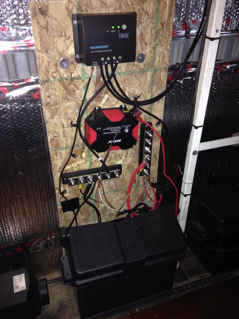

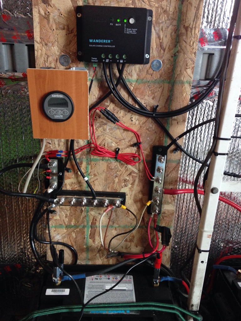

Updated final completion of control panel.
Removed 400 watt inverter, added Xantrex battery monitor (which I highly recommend).
Replaced 1500 watt modified inverter (not shown) for 1500 watt pure wave inverter (major difference).
Two new batteries added.
Also, added a cube fridge which I love, good bye ice cooler
