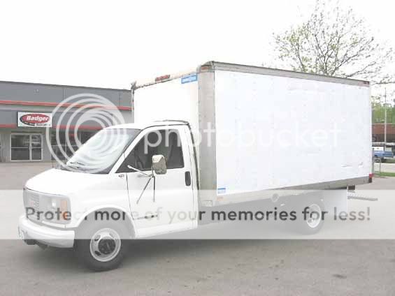

This white one is a bit higher than the yellow ones above, still not dock high though. Would you prefer this one? The box is 14'.

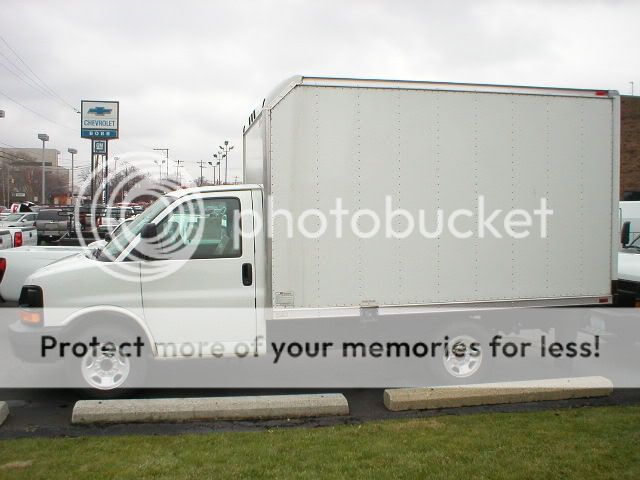

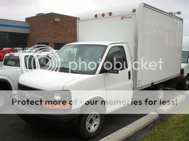

RE: GMC 3500 with 16' Box or a Sprinter, which is
I noticed the smaller 12' cube have a smaller engine, the 4.8L instead of the 6.0L. Also just 2 wheels on the rear axle rather than 4. It should get better MPG, although I cannot find any stats on it anywhere.
Anyone have an opinion on this truck
It has those wheel well indents into the cargo, the larger cubes are nice and flat, no indents. Also no door to the cargo area from the cabin so I'd have to cut one in myself, the larger cubes usually come with them. Should be good for 3 skids where the 16 footer can probably fit 8 skids if weight was not an issue.
