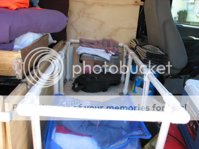

Jack_Berry
Moderator Emeritus
cargo van sleeping space
beds go here when carrying 2 skids. or when carrying one skid beds get pulled over this.
