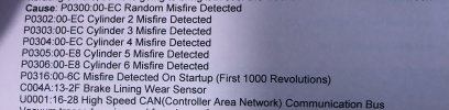

Hello,
My 2020 Ford Transit (gas engine) has it's check engine light on and is shaking when idling. The mechanic I took it to said it was due to carbon build up in the engine and they did a fuel induction service. It helped the the shaking a little bit but not much. And the check engine light is still on. He said I may need a whole new engine. Does that sound right? I never would have though I would need a new engine before 200,000 miles. However, I do sleep in it often as it idles and I have 6800 total hours of engine running time.

Many things can cause a multiple cylinder misfire. I'd spend more time finding the root cause before considering the nuclear option.

I did some searching for Ford 3.5 Ecoboost misfire and there are a ton of reasons. I'd skip the snake oil and find someone to diagnose it properly.
