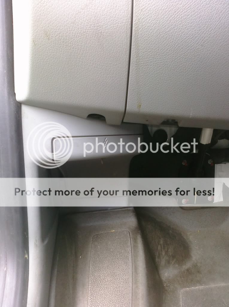

I have an 07, the E-brake is beside the drivers seat. However, there is a fuse panel there. And there was a compartment labeld ODB that I couldn't access because I don't have the right tool, it looks like there might be prongs under there to connect a computer to.
Here is what I'm talking about: the fusebox

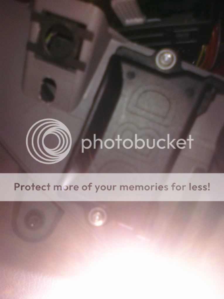

and in the fuse panel, there was this
Would that be it?
I should have said where the hood latch is....sorry bout that...
Star screw driver doesn't fit? or a 6 side driver?
