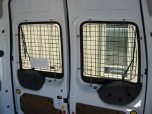

So im picking up this van tomorrow.. the Transit is the only one here in Canada its a demo and i can get it for a bit cheaper, otherwise have to wait 3 months for a factory build
The cargo glass is a liability/security issue for my company somewhat
For those who have gotten vans with windows what are the best options to cover/and or secure the rear windows?
I was looking at window screens but they do not yet stock them for this van as its so new. Also i was thinking about installing plywood on the inside.. which would take drilling some holes, and putting in some brackets/screws. it would not look the best
As for the outside.. is there some kind of adhesive vinyl or something to make the windows out of sight, out of mind. Im perhaps gonna get the company to get a logo to cover up the back windows from the outside and secure them on the inside with the wood or something like this.
really would be better if i can get this van without the window but its just not possible
any further ideas ?

First, I do not drive a van, but my first impression is that if you go with plywood and brackets, you could put a vinyl or cloth cover over it using screws with some sort of cover over the the screw heads.
in-Transit
I have side and rear glass on my sprinter for when I cooped up in the winter I can look outside.. Darkest limo tint will get it blacked out without putting a flashlight literally against the glass and a good flashlight too ... If that's not enough I also made insulating pillows that fit into the window frame ...
Sent from my flying circus ....
You can also use the silver reflective bubble pack insulation (Reflectix at Lowes). Insulates and privatizes. In my old van I just used 3M spray adhesive and glued it right to the inside of the window. Sure, it's a little white trailer trash, but it worked. But I also knew that I wasn't going to keep that van for years and years, and it wasn't a brand new shiny van.
You can get these security screens:
and then place some insulated material (or not) between them and the window for privacy, as well.

Now-- back to subject: Several years back now I had a Ford van that had windows in the rear doors just like we're talking about. Being the cheap Scotsman that I am, I went to the hardware store, got some paneling, some angle-- I chose aluminum because it came in the size needed and is a bit easier to work-- and sheet-metal screws. I made covers to fit the windows and installed them. Ugly as home-made sin but they got the job done. A couple of lengths of 1/2" drill rod mounted across each panel for security completes the job.

Since this a brand new van it will be hard to get the blank out panels.. apparently cant get them through Ford as hard as it is to believe Contacted some body shops like Maaco theyre gonna look at it tomorrow and see what can be done and what price. Also there is no doors to swap out .. and that would be the most expensive i bet the window cages are 150$ and outside van wrap decalling can prob be fit to size to hide the fact there even a window ill post the pic of the final outcome :)

What Ekhedge said. I've got a Chevy with much smaller windows than the Transit. I used dark limo tint on the glass. I then cut two pieces of 1" styrofoam board and glued reflectix to the side facing the glass. My windows are hinged so the styrofoam boards are held by small bungee cords that allow me to remove them easily. For security you could cut plywood to hold the styrofoam and use some small screws to secure it to the door.
The large windows on the Transit may be a challenge for the do-it-yourself person. Handling the tint film gets tricky. You could check around for a place that does tinting. Ziebart does it. A cheaper method would be to paint the inside of the windows and then insulate and cover with plywood.
