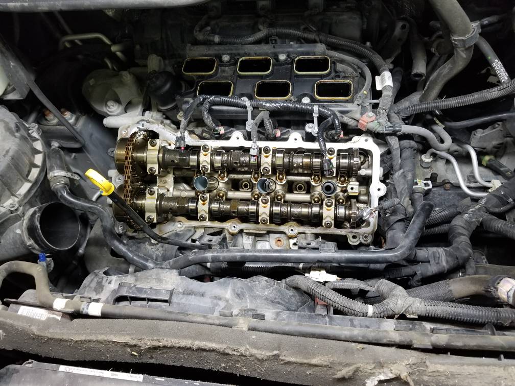

    We have all heard the Horror stories about Sprinters , Promasters ,Transits ..
    This topic will shed some light on Promaster 3.6 engine repair ..

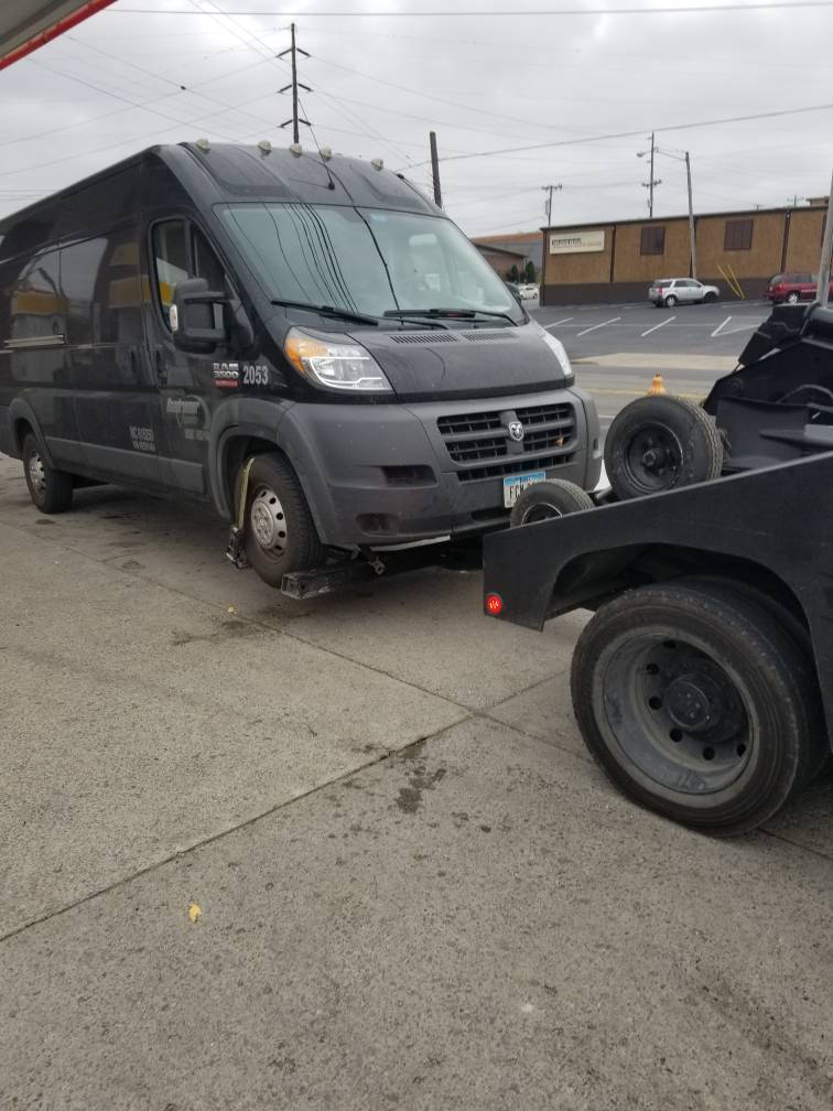

    Van towed in this morning ..
    On route from Laredo to Tn ..Thursday night south of Waco .. loss of power .. blinking check engine .. 30 seconds the light went solid on .. found no issues ... 800 miles later ..last night west of Nashville .. same issue blinking light .. 3 times over 10 miles .. the 3rd time there was loud ticking or knocking noise .. went off interstate to convenience store ..parked van .. called in to dispatch .. rescued load .. this morning towed in Dodge Ram dealer ..van went into shop 10.30 am .. meanwhile i was taken for rental truck .. when i arrived back at dealer .. Mechanic had front of van disassembled and top of motor ..
    [​IMG]
    Problem found Rocker Arm Followers(2) over #6 cly. had went bad ..causing damage to Left Exhaust Cam shaft .. also causing # 6 misfiring ..
    Ordered parts .. should be fixed by noon on Monday ..
    OK.. while taking personal items out of van and putting in truck ... they discovered a Dealer in Nashville area had parts on hand .. bingo .. they went and picked up parts .. 1.20 pm the mechanic started reassembled engine .. by 3 pm test driven and interstate test driven.. purrs like new ...
    I paid the $100. deductible.. plus 6 new spark plugs .... total ..$254.28
    Without Chrysler 200,000 extended warranty bill was over $1100..
