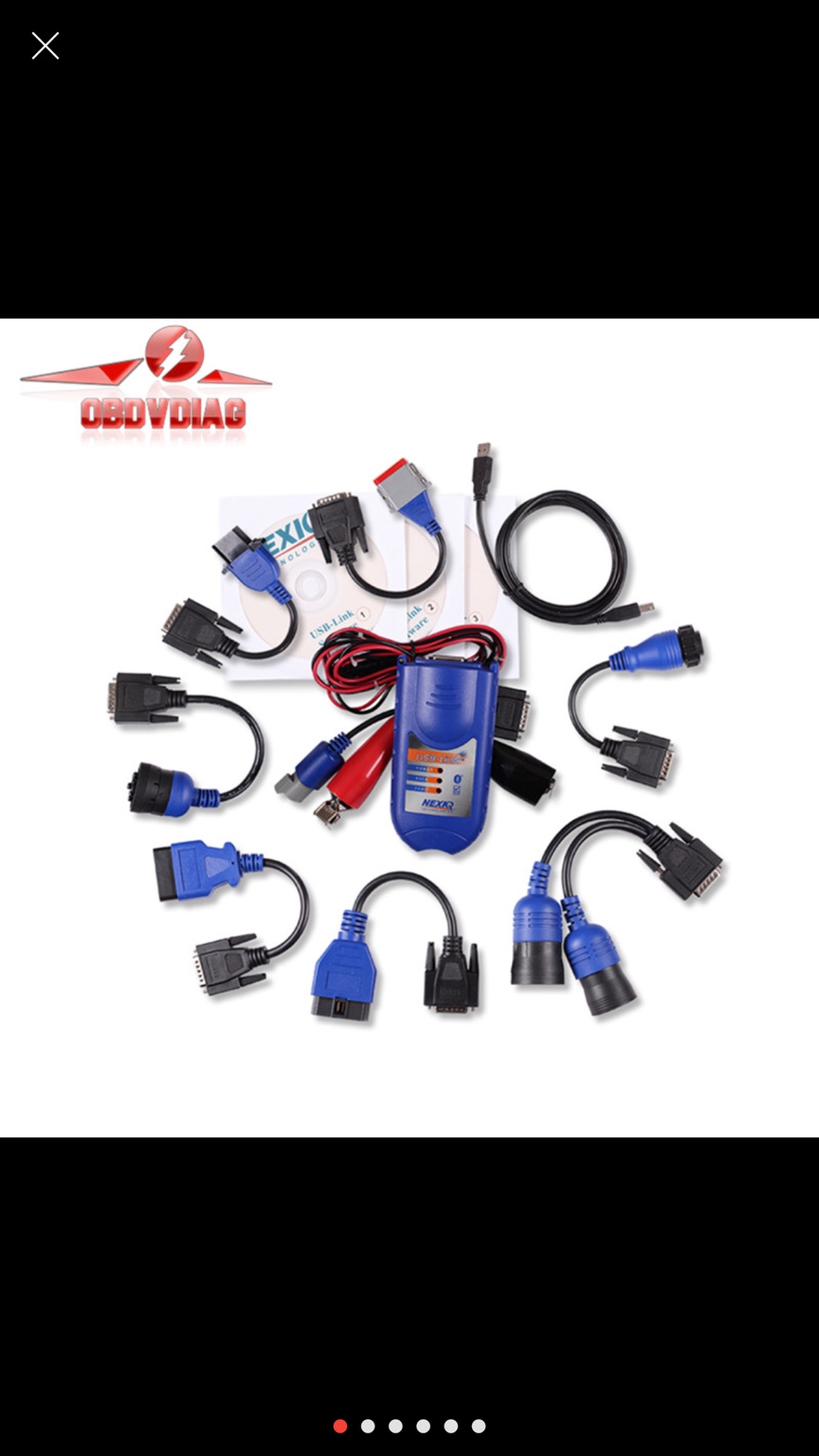

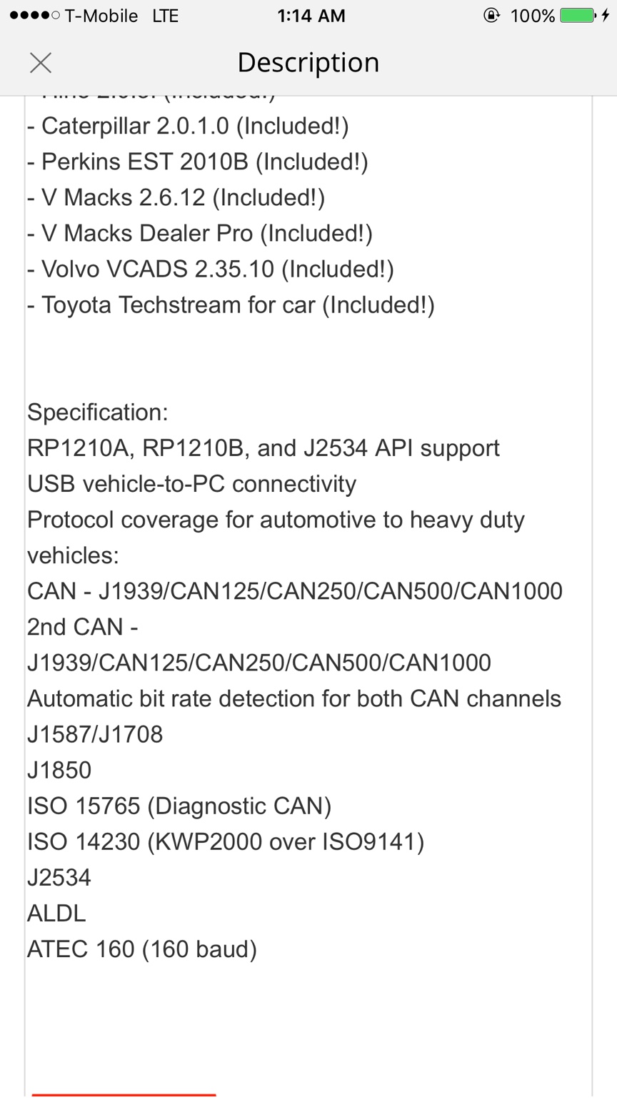

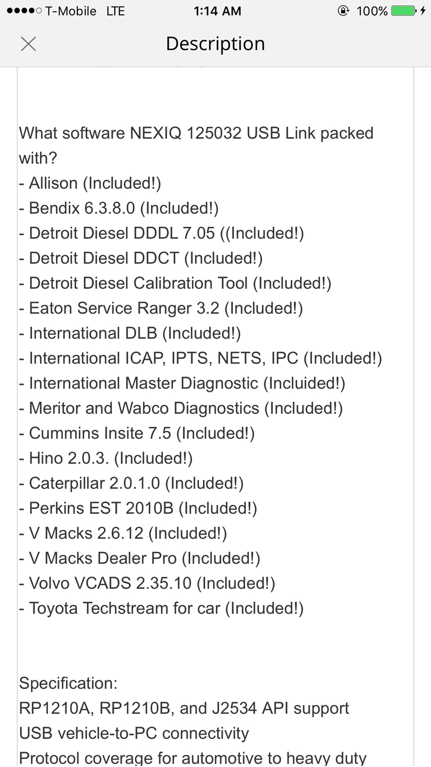

I paid 250 for the software and machine, computer wise I'm going to use my current computer or an old one that I rarely use anymore. There are CDs enclosed with the purchase which of I'm not mistaken have the programs on them and just run from there or get downloaded onto the computer, weather I have to subs did or not I'm not sure yet as the product still has not arrived in the mail. It's the older model from the company, but that's the least of my worries as log as it does the job for me I'll be happy. Here are some pics from the listing
