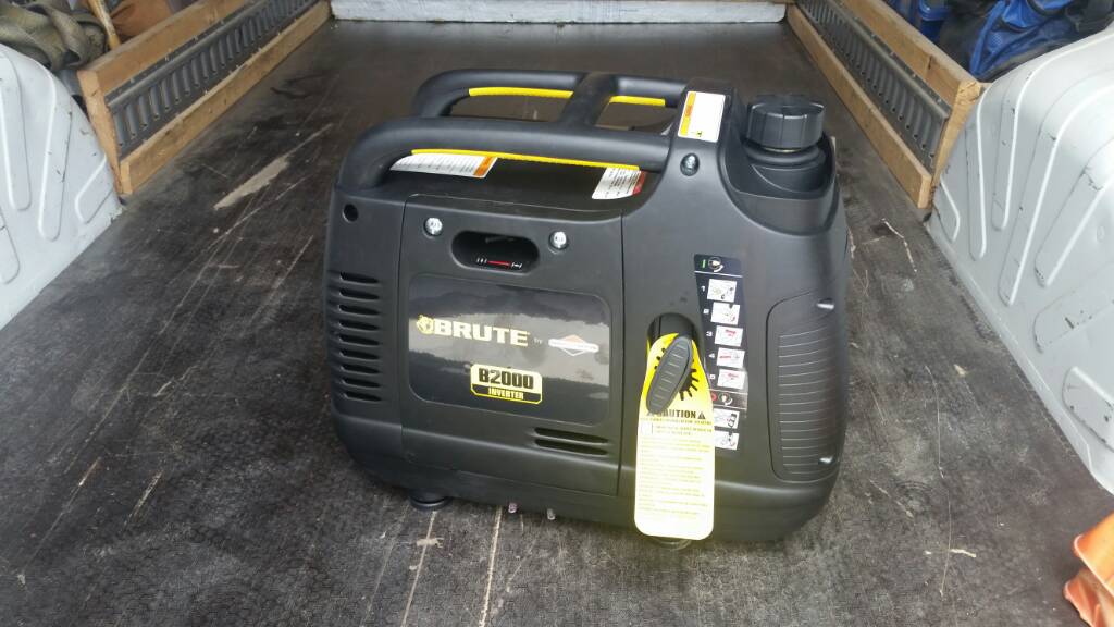

Under $ 375... clearance at some Menards ... .. love mine ... sat it next to a friend of mine's Honda in Laredo with both running under loads .... similiar in sound .... and mine ran longer on gas ...

alright 10-4 on that, that one ntimevan posted might be a lot better i was using one of those big 4000w champions mounted to the back so maybe it wont be so bad if i get a smaller and/or less powerful one.

Those champion at Lowe's are loud! 68+ decibel I think. I've got a Honda 2000 watt with a 6 gallon extended run tank and I ran it for 48 hours straight and still had another 24 hours left. It was on eco throttle the whole time.
I would trust ntimevan and for that price that's not bad. I Change the oil in mine every 100 hours and use Mobile 1, the green cap.
I also would get a maximum security cable lock for that and the gas can as well. The best is a swing out basket. Xiggi and I have one and he has pics of his on here.
