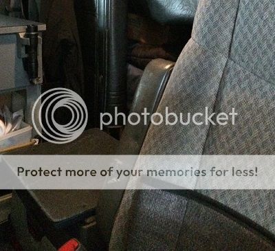

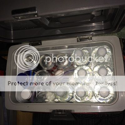

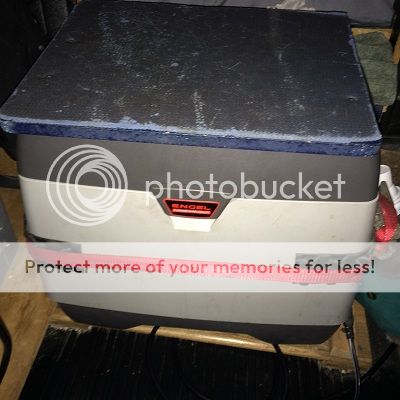

I have an Engel MD-14 refrigerator/freezer mounted next to the driver's seat. I added a top "extender", a piece of particle board covered with a piece of a cheap yoga mat. This gives me a larger, non-skid surface table top. I have the unit plugged into a switched, 12 volt outlet. This enables me to turn it off and on as needed. The Engel is insulated well enough that the contents will stay cold, even in 90° temps without running for more than 12 hours. It will also keep things from freezing in below zero temps without running.
Engel refrigerator/freezers aren't the cheapest but I'm very satisfied with mine after almost 3 years of use. Thanks ebsprintin for providing info that helped me make my decision to choose an Engel!
The MD-14F needs 3½ to 4 inches of clearance on all sides for ventilation. I mounted mine on a platform about 1 inch off the floor. This platform is open in the middle to allow for extra air flow and to keep the Engel above any snow melt and various floor junk.
The Engel MD-14 doesn't hold a lot. I would have gone to a larger size but I wanted it to fit next to the driver's seat and have more than adequate ventilation.
