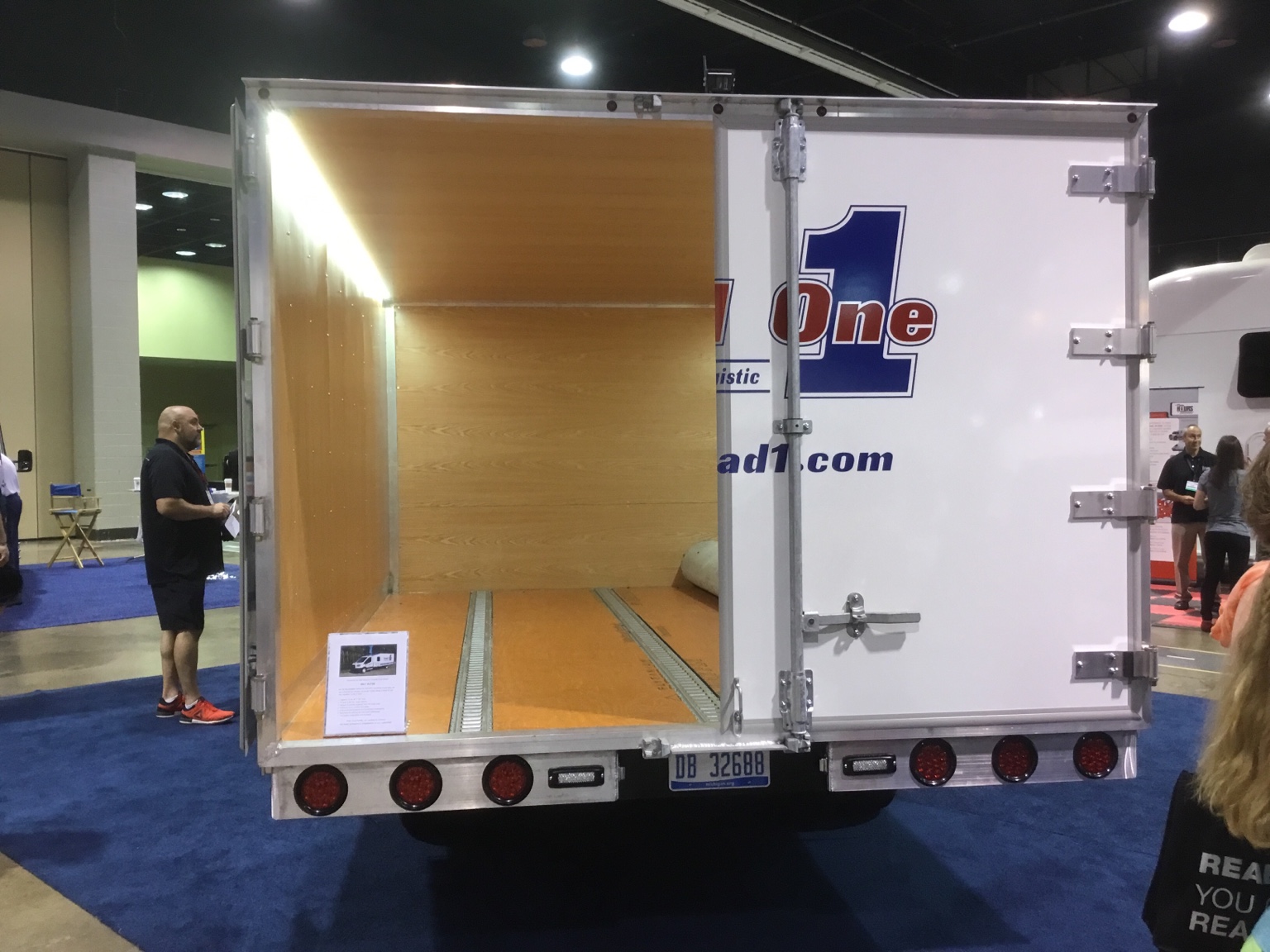

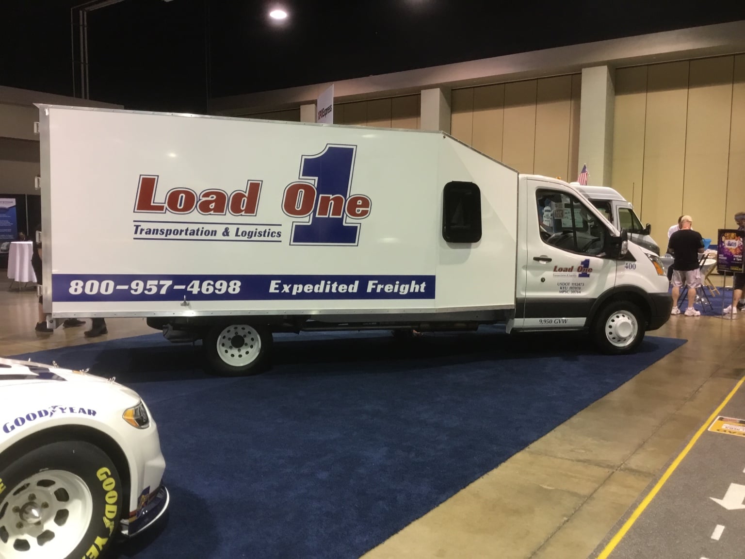

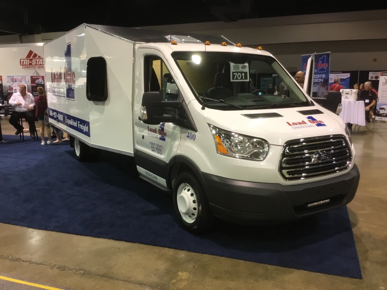

    Custom built by one of our great fleet owners. Under 10k, 6 pallet with a sleeper. Really sweet set up![​IMG][​IMG][​IMG][​IMG]

    Looks nice ... but 6 skids .. a few questions now ...
    Current scale ticket ...? And i am talking a picture copy .. not hearsay ...
    Available cargo weight then ..?
    Since hauling 6 skids will this Van be Str- 8 Rate = $1.45 plus ...?

      Can we see some box dimensions and chassis specs?
      Engine, 3.7 or 3.2 Power Stroke.
      Axle ratio.
      Wheelbase.
      Empty weight.
      • Like Like x 1

      3.7 gas V6, 178" wheelbase, 4.10 limited slip axle

      5,700 lbs. empty, 9,950 GVW, 4,000 lbs. capacity

      It is all Westmicher said...i saw it. He also avoids the Transit Guibo problem with a 2 pc drive shaft.

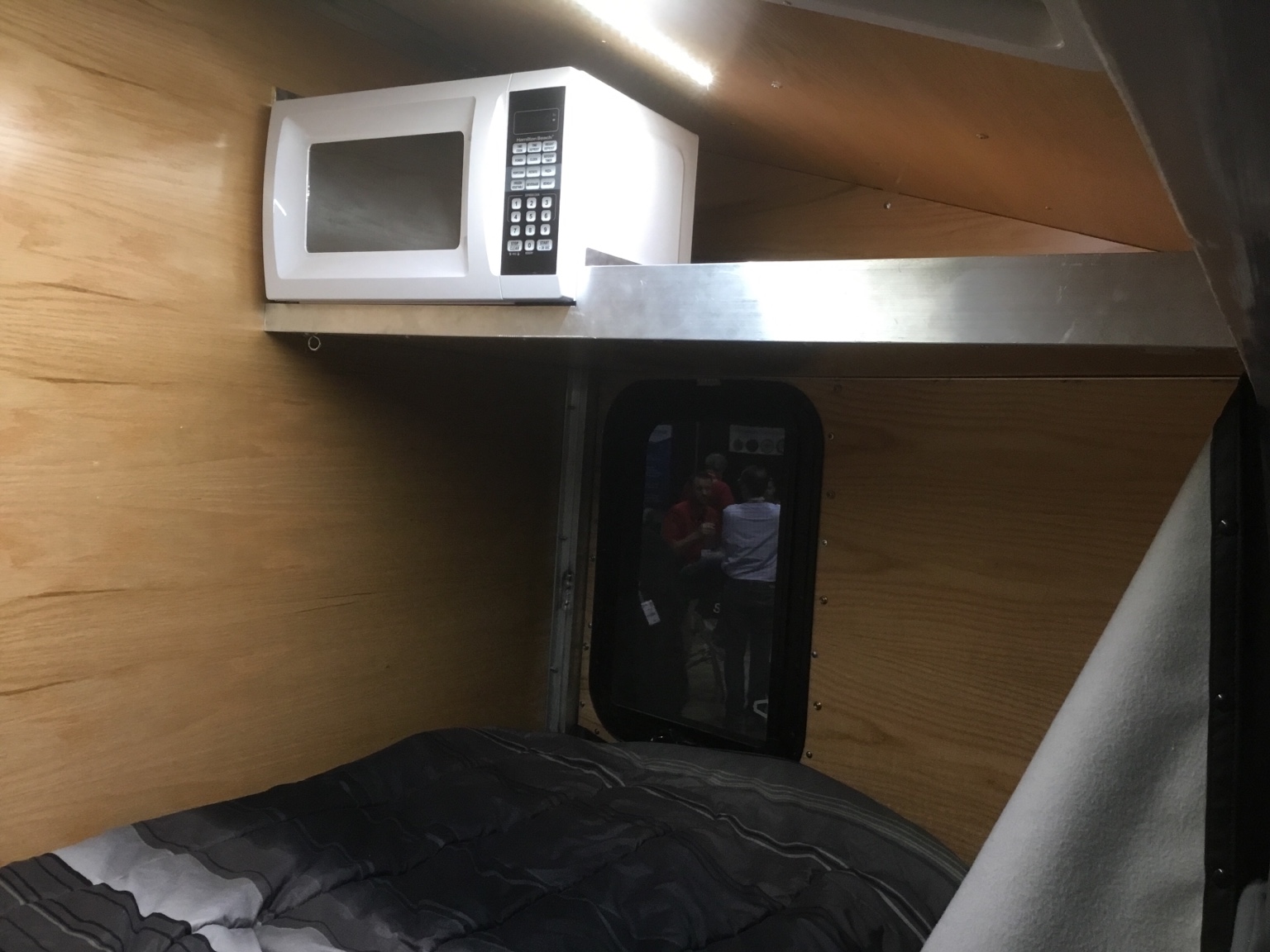

      Keep learning & evolving right ...? Looks well thought out. What are the interior dims for the box? Only 1 driver? I would think a team would be a better fit ...

      Sleeper looks tight for a team, IMHO. I would go with four skids and a good size sleeper, for a team, and I'd bet one could make some sweet bank with it.
