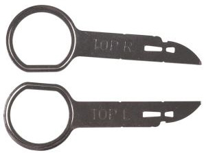

You can do that. If you don't have them, go to Autozone or Walmart Best Buy and get a $5 pair of those radio puller thingies. The ones you want look like these:
Report the radio's serial number here. Or call a dealer's Service Desk and give it
to them.
