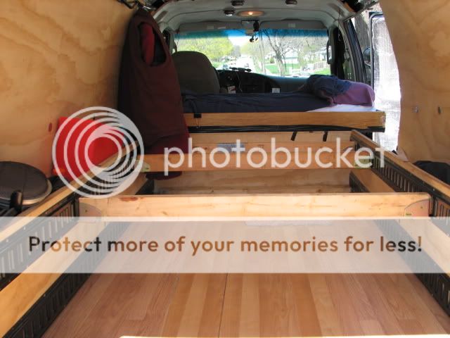

I used large self-tapping screws, about a foot apart, around the perimeter and down the middle. I laid out e-track on the floor so that the outer edged of the e-track were 48 inches, and then installed them with screws about every foot, as well. Then measured the interior between the inside edged of the e-track, and cut the 4x8 foot plywood to fit in between the e-track. I have 9 feet of cargo space, which meant I had to add another foot of plywood to the deck, added farthest from the rear doors, then filled and sanded the seam.

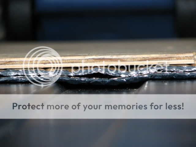

Decks in cargo vans are subject to a lot of skids being scooted and dragged, so the decking can take quite a beating with all the scars and scrapes. Many people flip theirs after 6 months, then after another 6 months they replace the plywood. I gave mine 3 or 4 coats of Minwax Polycrylic, which not only protects it, but makes cleaning it very easy. Oil and other stuff won't seep into th wood. Instead of flipping mine every six months, I add another 2 or 3 coats of Polycrylic. Mine is still going strong after more than 3 years. I did have a forklift operator somehow manage to slide a fork into the edge of the plywood and take out a chunk the size of a dinner plate, but regular ol' automotive Bondo, a power sander and some more Polycrylic fixed 'er right up.

I welded my 2 -8 ft sections of e-track to the floor, about 24 inches apart, so that I can still secure smaller freight down as well as full-size.I also welded 1 section to each side wall.My van came with metal studs that were welded to the floor and to the top corner inside, about every 18 inches, with wood strips screwed to them lengthways. This made things a whole lot easier.As far as the plywood is concerned,I used 3/4 inch and cut it to length in 8 ft strips to fit in between the e-track, and used self-tapping screws to hold it down, and then polyurethaned it twice.I have 8ftx 53 inches wide of cargo area.No problems getting freight inside yet.I also welded 12"x 8' long sections of steel along the sides and front of the cargo area to keep freight in that area, etc.A little heavy, but it works.Insulation and paneling will be next someday, along with a roof vent.

I personally prefer E-Track recessed mounted on the floor. I use Tec Screws and wherever possible stainless steel bolts. My first van I went with a plywood floor. My current van has a plywood subfloor and a composite plank top floor screwed to the subfloor.

Moot. Is that cross piece of e-track at the door of your van? I added a piece like that at the rear door to give me extra forklift-driver-protection. Also comes in handy as anchor point for the odd, long piece of freight.
eb
ebsprintin
Oh, and the seams. I got lazy with the seams. No special treatment. Just screws within two or three inches from the edges of the joining panels. The panels went in lengthwise, so the first seam to run into a sliding skid is eight feet into the vehicle, so lot of freight never makes it to the seam. A year and a half of expediting and the seams are no worse off than the rest of the floor. The poly coat seems to be the key.
eb
Yep. Vertical E-Track.
Yep, that's why its there.
Yep. I use it for that also.

A friend just gave me this tip yesterday. Take a 3 foot by 3 foot piece of carpet, spray it heavily with silicone and turn it upside down on your sealed floor. Have the fork lift driver set the skid on the upside down carpet and then slide it on in.
