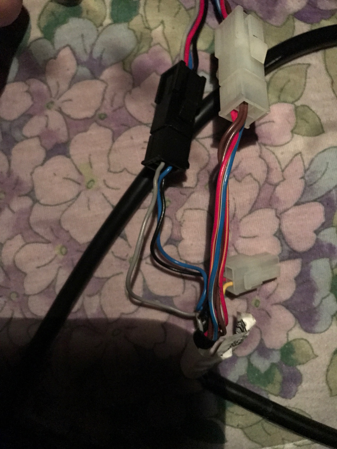

That one to be exact, and it randomly stopped working. It turns on for maybe 20-30 seconds and then shuts off again error code (1E 31). Sometimes it'll stay on but blow cold air and it gives me an error code on the thermostat (1E 90) and it'll shut off when I try to go back and turn the temperature up or down and it'll give me another error code (1E 80). I noticed on the thermostat one of the wires was pulled out of the fuse( at least I think it's the fuse) here's a picture.
The black "fuse box" is what powers the heater and the grey wire was hanging out of it when I noticed it wasn't working. I plugged it back in after a few attempts and tried it again and still nothing. I can hear the fuel pump turning on when I turn the heater on so I'm sure the fuel pump works. I'll have to wait until I'm at home to test it to be 100% sure. I've already ordered a new thermostat and I hope that solves it. Anybody else know what the problem might be?

Here's a better picture of the wires

Okay so 1E90 means "Glow plug broken circuit" so that would mean the loose wire is the problem, or should be the problem.
That sounds like the problem, that mole X style plug is easy to repair, strip the wire back if you can get the terminal out and reinstall it, other than that you might be able to solder it, if your so inclined splice a small wire and connect to the same color one on the other side, it just wouldn't be as easy to remover the harness in the future when moving the unit into another truck.
Will try and do this. If anything I'll just get another glow plug.
