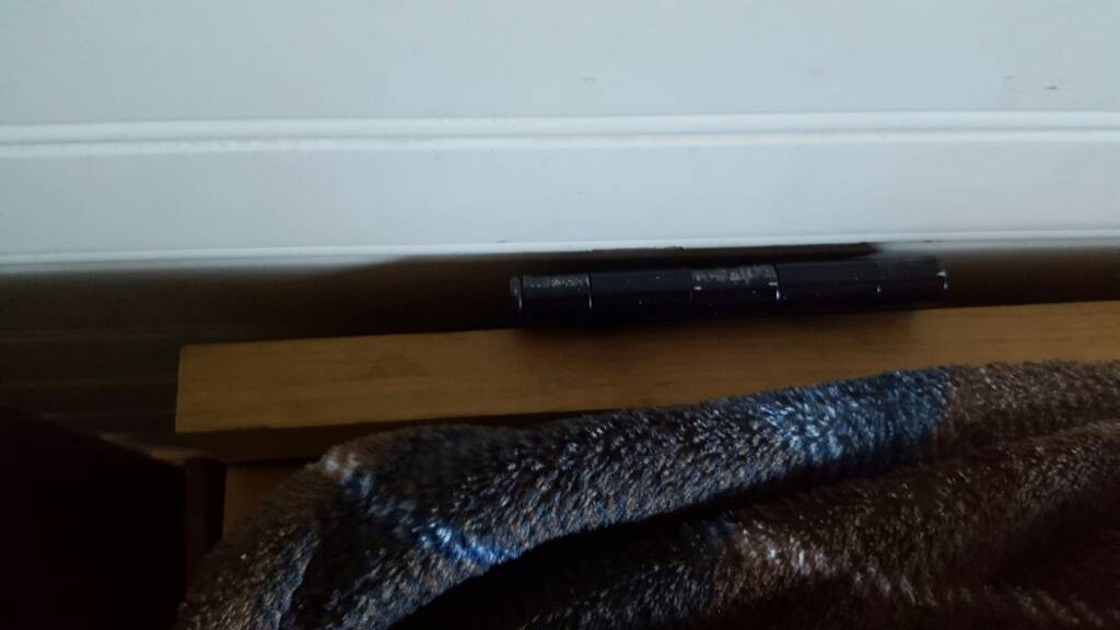

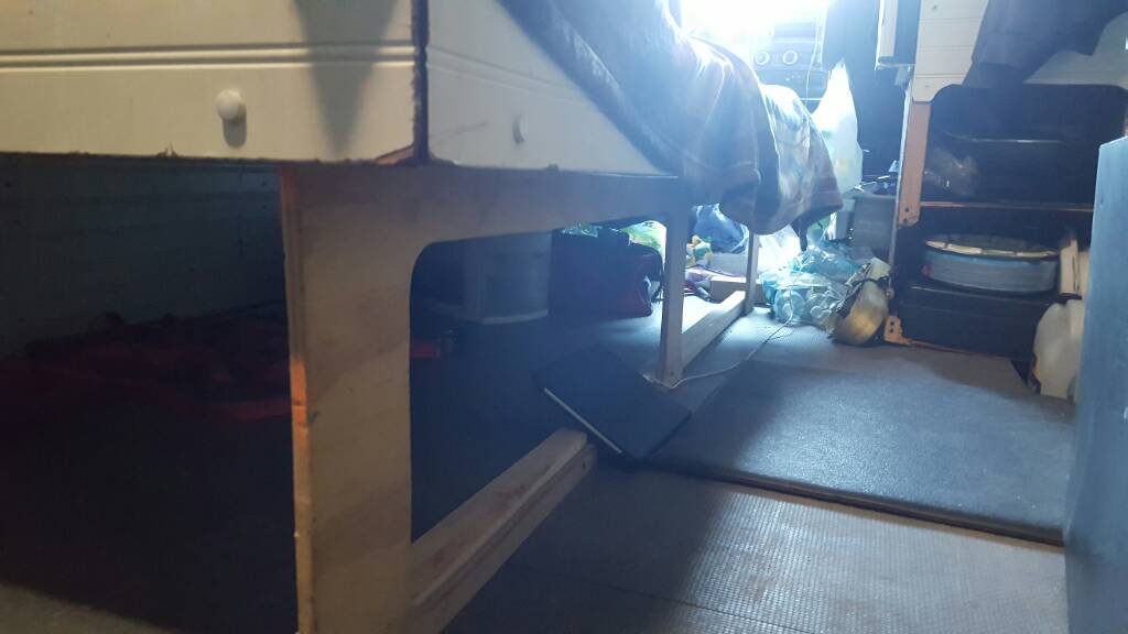

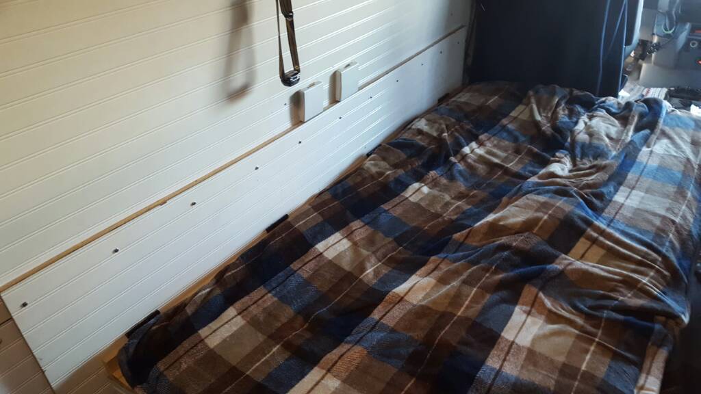

I first screwed a piece of 3/4 ply to the wall that ran all the way to the floor. I screwed attached the bed to that using 4 heavy 4 inch hinges. My thinking is the van metal isn't supporting the entire weight it also transfers weight to the floor. I weigh about 210 the one full length drop down legs is plenty of support. I probably should have used 1/2 inch on the support leg rather than 3/8 it did tend to warp over time. I should have used some cutouts in the bed frame to lighten it.
