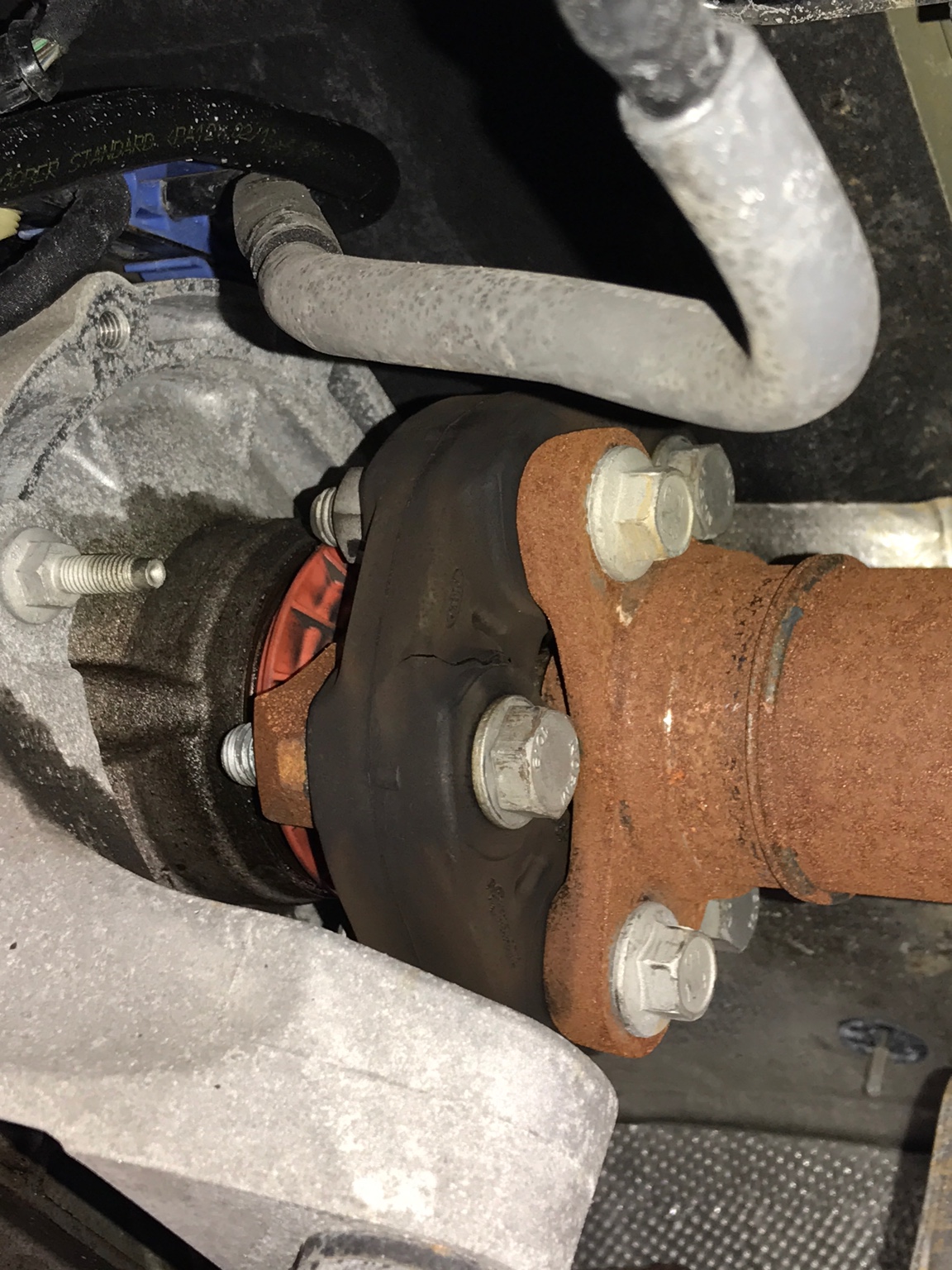

A giubo, also known as a flex disc, is a POS connector between the transmission output shaft and the driveshaft. The Ford Transit giubos are known to crack at the bolt holes, eventually failing.

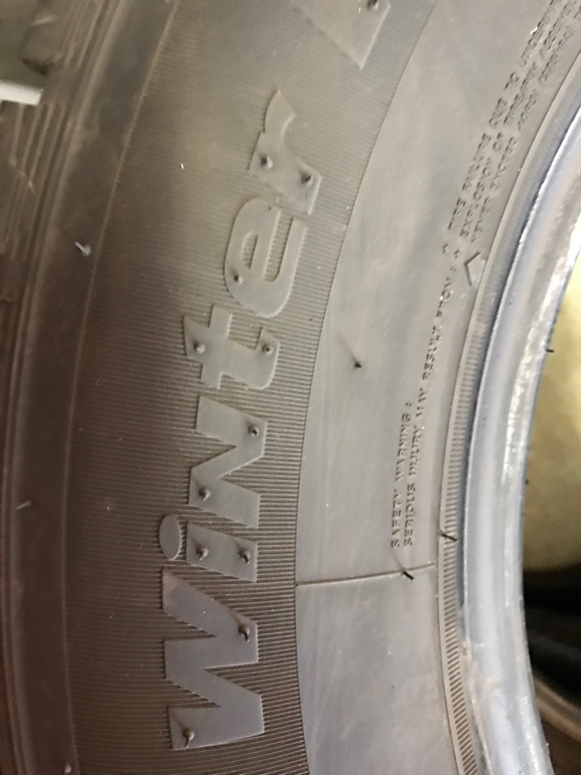

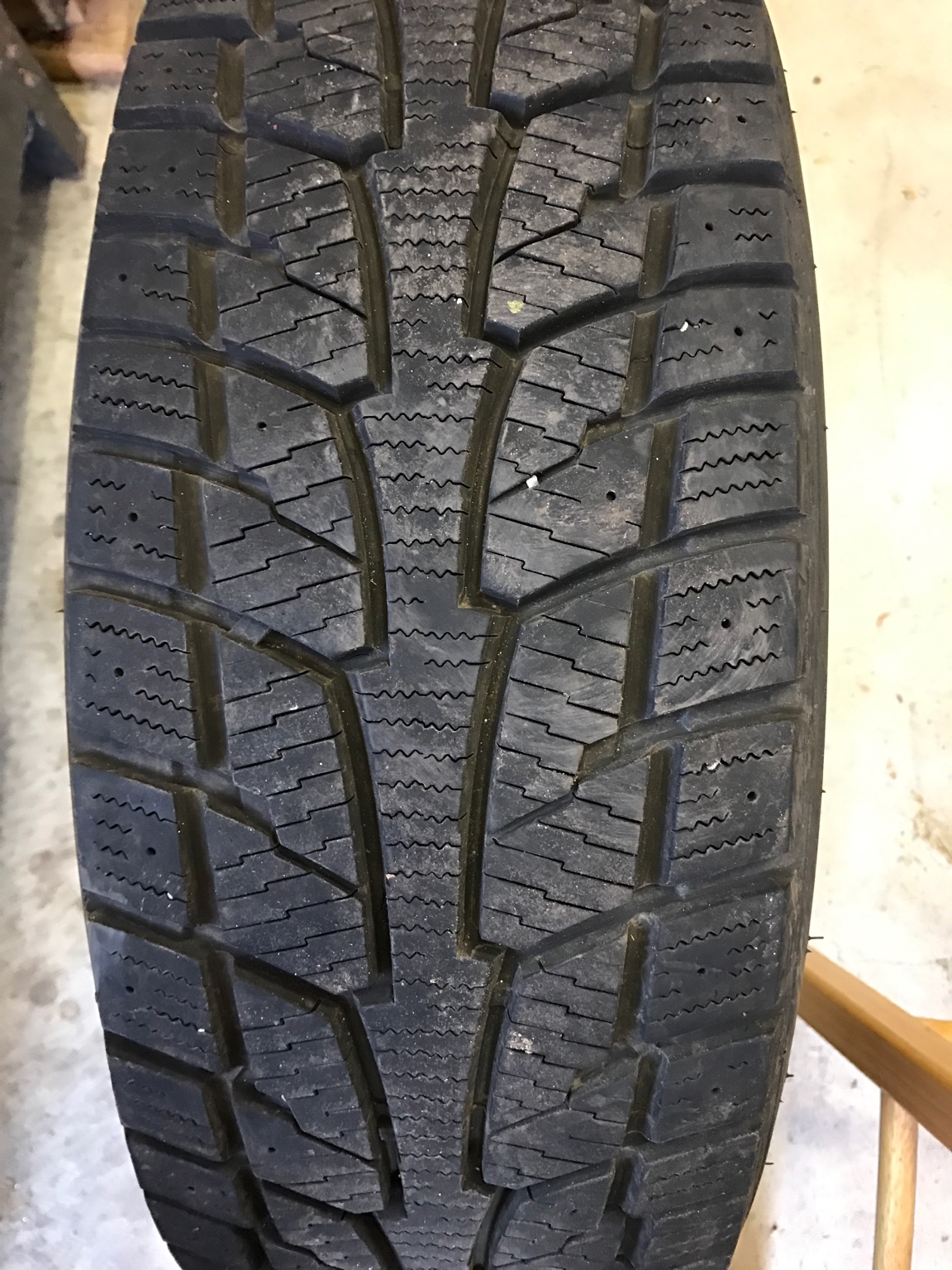

Another update on the Hankook winter tires I bought. They were the exact size and load rating that came on my T350 new. I put them on in November and used them until today. So they have about 45,000 miles on them. The traction on both snow and ice was exceptional. Loved the tires but they made a bit more noise at slow speeds. They have plenty of tread life for another Wisconsin winter. These pictures are the tires at 45,000 miles.

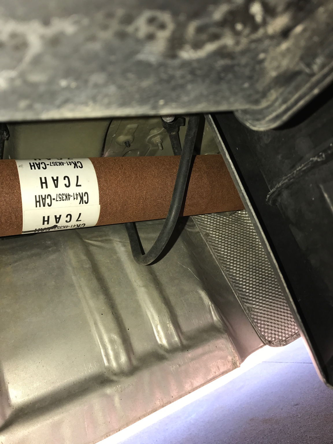

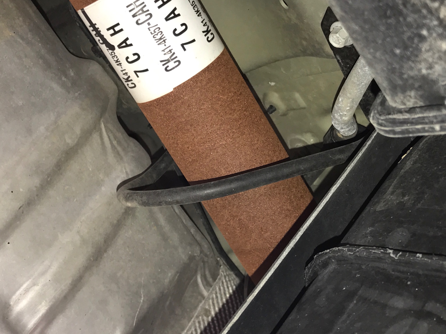

And just crawled under my van. Had the transmission to drive shaft coupler replaced under warranty. This new coupler looks different then the original one and I noticed they installed a driveshaft loop to contain the shaft if the coupler ever did fail completely.

Wow, such a patch work. They should be ashamed of themselves for coming up with such a thing. Is the giubo cracking again?
Offline
Yeah it looks like it is cracking again. The sprinter uses the same type of guard on the driveshaft.
FlyingVan
Offline
The one on the sprinter doesn't look anywhere near like this one. This one looks like an afterthought. I'm sure it does the job in the event the driveshaft falls off for whatever reason, but ... Anyways...
